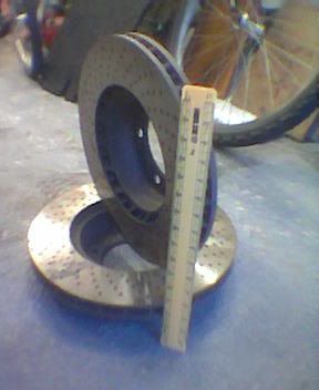

And if your going to go fast you need to stop

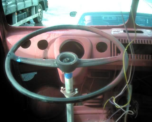

All in a very solid bus, worst bits were the drivers side rear corner and the dash, which had been cut
