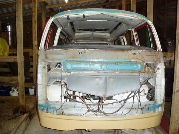

I purchased my baby back in 2004 off Ebay for £700 after having a couple of years of hell with a 1974 lawn mower 1800 bay. The guy I bought it off had started to convert the bus but never really finished as he found the amount of welding required to underside of the bus was well beyond him.
I have lots of pics in the link below of my Resto which is still going on. The bus is running at the moment but gearbox is shot and have just managed to get my hands on a 2ltr box Happy
Anyway a few pics -
Before :-
After :-
Fabbed Exhaust which wraps up round the top of the g'box
Mounting for rad with a pair of M'bke fans
Rad in situ
Heater matrix under RnR (minus the RnR)
with RnR
Now all geared up for a final push to finish off resto, upgrade brakes and install a TD motor Grin

Made a start on final part of my restore...
That's the easy bit done..
