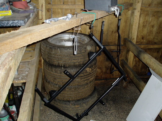

rear heater blower from my long since departed ROver 400...it sucks air through the subaru matrix mounted underneath the van. meaning I can save a fair bit of space under the rear seat.....the big tank is a 120L lpg tank. oh and ive also now removed all the interioir...

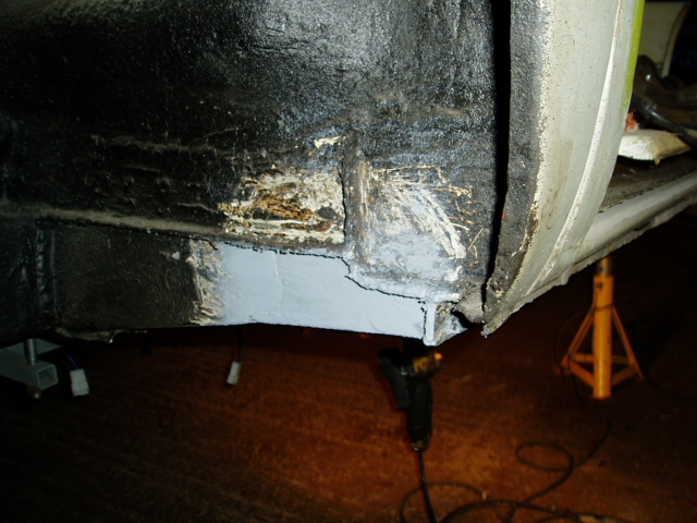

in the process of doing the same to the rear i realised the jack points from a few years ago werent really up to screath - plus i needed to make a local repair to the chassis rail....(JPoint isnt welded on there yet as i decided I may as well take the ooportunity to renew the rear x-member - although its OK its not good enough and I dont want to do it in a few years time!!)

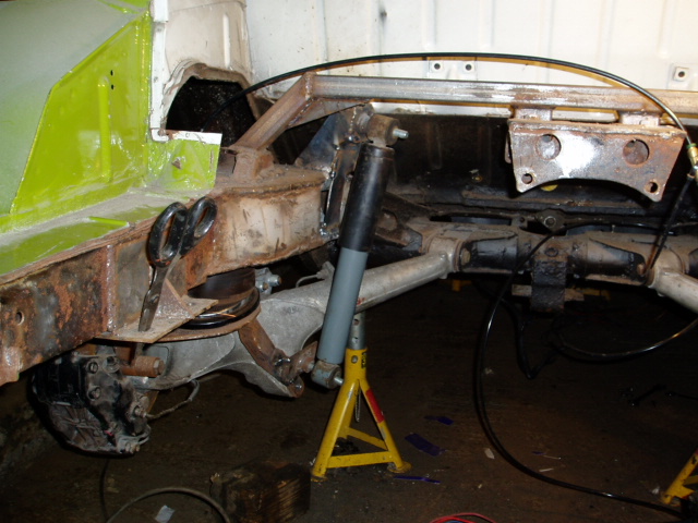

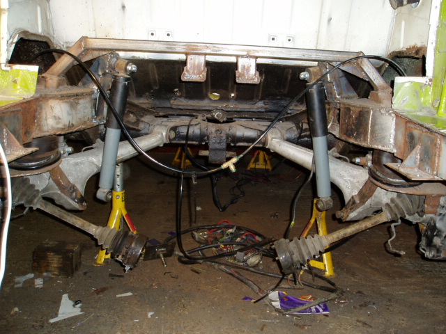

finally some progress......mainly been doing the upper shock mounts - getting the angle of the dangel right was a bit difficult.
bottom mount is only mocked up...due to using the porsche shocks I had to make some new m14 bottom mounts and mount em at a different angle to that in the arm...
I also did some painting of bits...since im now getting towards the end of the welding (im working front to back.). the next step is the cleaning, stripping and refit of all the underneath components that ive been trail fitting for the last year.

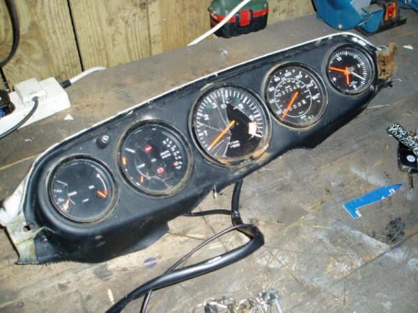

and heres my 911 dash...got for a bargain 60 quid form the local scrappy.
