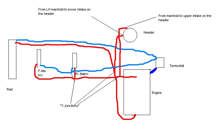

Thanks man...my english is abit rusty and "norwegian" but i andestand about everything.....exept...what is the "header" on the drawing? is that the inner expantiontank?
I have now removed the termostat and the water is sirculating....however....when i took the termostat out i managed to get about 10 liters out of the system....when i filled it up i got on some close to 15 liters...so there is dissapearing water im afraid.

I have made a drawing in paint over my system now this morning....its not exactly the same....
Can sombody please help me putting it on the forum...i tryed, byt my computer knowledge is worse than my english  _________________ Subsyncro =) |

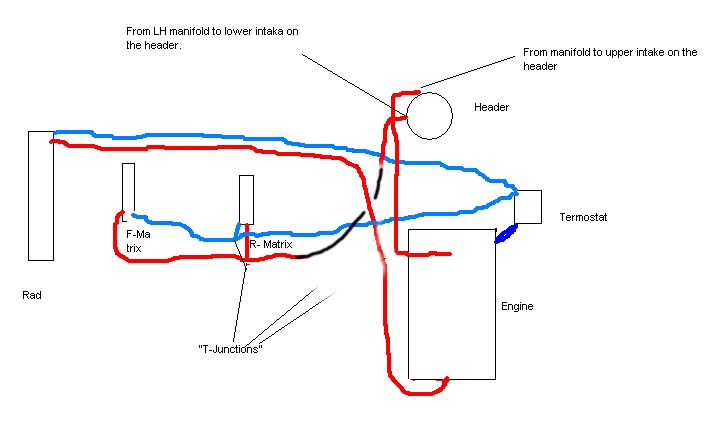

Posted: Sat Sep 20, 2008 7:24 am Post subject: |
(From the file you sent me -ES) _________________ Subsyncro =) |

ElusiveStranger Darth Admin
Joined: 23 May 2006 Posts: 2527 Location: Mudway, Kent
Posted: Sat Sep 20, 2008 2:11 pm Post subject: |
Sounds like you have an air lock causing the problem.
Header tank = Expansion tank.
If the Engine is plumbed in like a Subaru you must ensure that the matrix lines aren't blocked. (the steel line from the water manifold to the 'stat)
On the T3 I believe there is a valve on the matrix to stop the flow of water. You must not shut this. That's why some use a "bypass valve" - it allows hot water to always circulate.
Check out Rich Jones' schematic for T3s:
http://www.rjes.com/html/general_schematic.html
Have a good look at that as it works well
Mine's a T2 and the heater matrix has water flowing through it all the time. It gets hot but with no air blowing through it
Check that your hoses have no air in them.
Changing head gaskets isn't too difficult. Will take about 3 hours the first time.
PS - your image isn't on your site. You did the link right though _________________ The advice you receive on here is worth the paper it's written on.

Could somebody put my drawing of the colings sytem on the forum? Just for people to see if they can see any "mistakes" done during the conversion
I have made the drawing in "Paint" and reformated it down to jpg. but stil it is to big for the forum? _________________ Subsyncro =) |

the first thing i would do is put the H section in the heater pipes so it wont matter if the heater is turned off again _________________ vwdrc class rep

Hopefully this will sort out the airlock.
Make sure you have flow through at least one of the matrix, if not fit a bypass
Then you'll have to fix your gaskets! _________________ The advice you receive on here is worth the paper it's written on.
