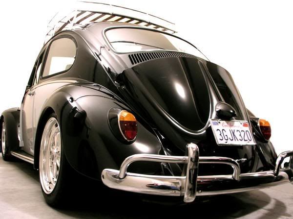

it doesnt have to look bad Grin
depends what you wanna do with your car? Grin
