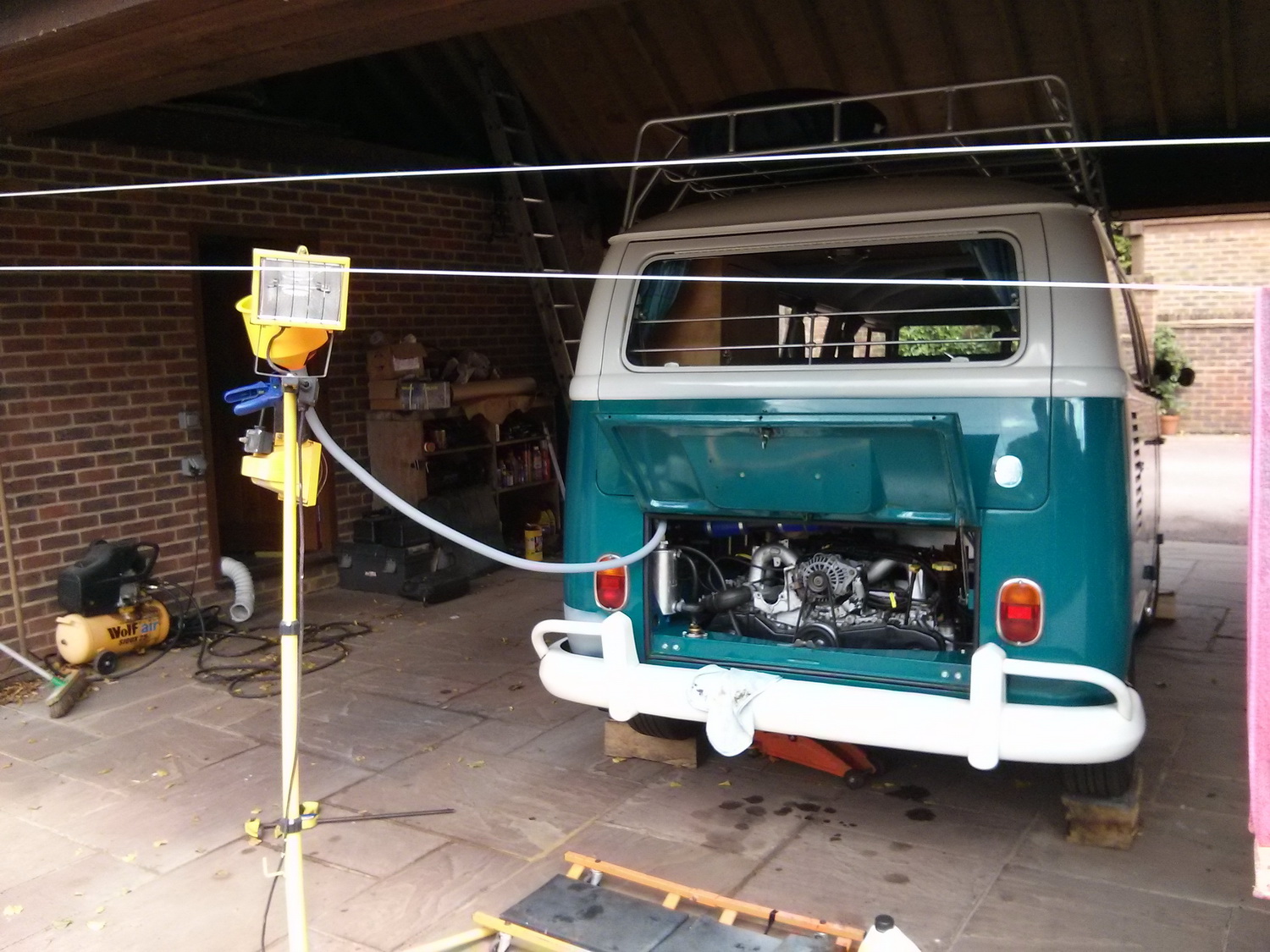

PostPosted: Sat Jul 25, 2015 3:12 pm    Post subject: Reply with quote
Here's me bleeding mine
It's an absolute bugger to get all the air out
