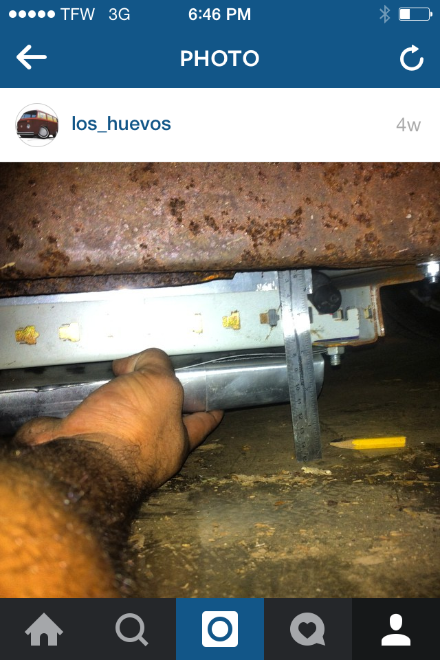

Just the lighting and crappy cell phone pic really jacked up that engine pic. It's actually hemi orange. Yup, right now just blowing past the fans. I tried to run a scoop but it didn't have any affect, actually made me run hotter than before. The rad is literally 3" off the ground so I have been trying to play with the idea in my head to create a side scoop that will run to the rad from the side and create enough high pressure below the rad to to flow through it. I'm pretty sure my pressure situation needs to be fixed down there. Here's a shot of my rad and the distance off the ground!

poo that's low.
I have a rad in the same position, but with a scoop. I never had the fans coming on on the highway...
It's really possible to make some improvements there I think.

Yeah being low is not practical. I'm thinking about raising it a little. Maybe that will be my winter project.
