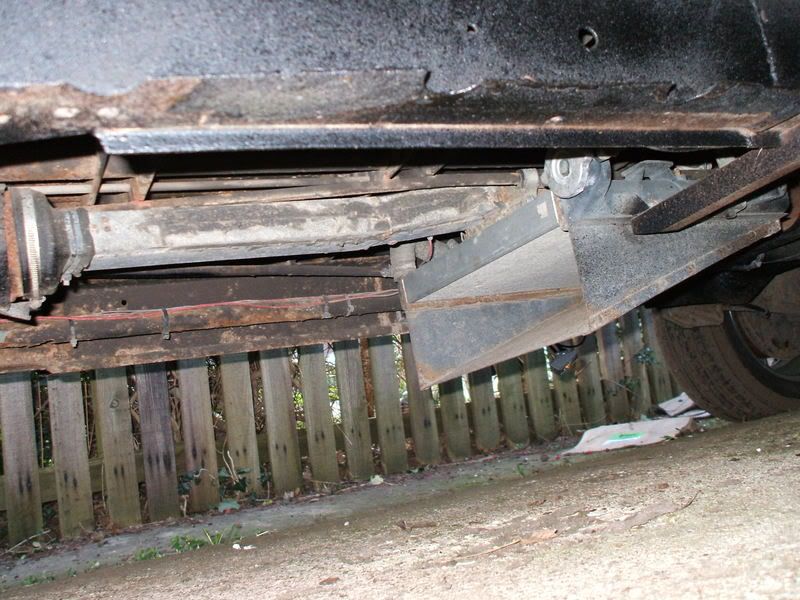

PostPosted: Tue Feb 06, 2007 7:49 pm    Post subject: Reply with quote
Yes someone has got a type 2 with a pug TD 2.1 Thanks for the belowe Nath
original intercooler off xantia 1.9td - changed to 2.1 after headgasket blew, rad at back is a waste of time and effort, just put big one underneath. learnt the hard way, micra rad for additional cooling and ducting that goes to original heat pipe into cab. Only downside is when it rains- the cab fills with steam!
PostPosted: Tue Feb 06, 2007 8:13 pm    Post subject: Reply with quote
No different to a 'normal bus' then Grin

PostPosted: Thu Feb 15, 2007 10:54 pm    Post subject: Reply with quote
Cool that looks a good fit , could do with a high ratio box for better motorway speeds at lower rpm's

PostPosted: Sun Feb 18, 2007 4:34 pm    Post subject: Reply with quote
Am getting on with mine, the rear mount where I had the previous engine top mounting is being ground off and I'm going to get a pair of LDV Pilot engine mounts from an LDV Breakers here in Warwickshire. I'm then going to mount them on a new under the sump bar to support the engine properly like a rear wheel drive north/south engine used to be supported in the good old days, haven't quite decided if I can get enough strength to each side without having to go all the way under the sump yet though.
I would prefer it if I didn't have too, it would make for a much cleaner installation and make for quicker engine removal.
